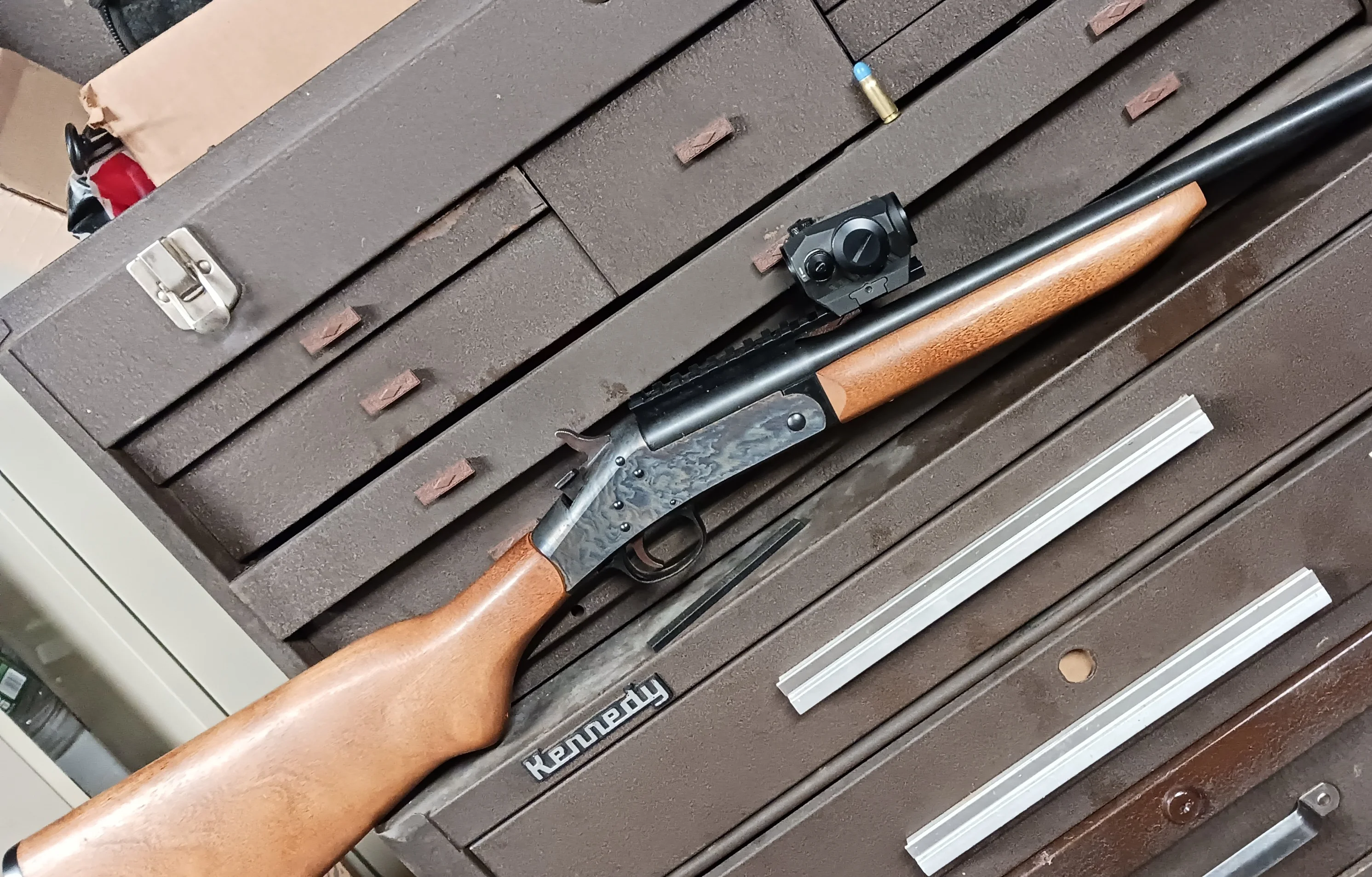

My last "fix up" was drilling and tapping for the tiny machine screws that hold down a scope rail. Just not alot of thread bite to make me happy. We will se how they hold?
A buddy of mine had the same problem with the short mounting screws for his rail. He was able to find some longer ones that worked, I'm sure if you look around you'll be able to find some. I wish you luck. As common as that problem is you think they would make them a bit longer. I've seen it mentioned on several forums.
I don't know if I really want them any longer? I wondered about how deep I really wanted to drill into the metal around the chamber. Not concerned when I have the adaptor in but when I shoot a regular shot shell those three screws holes make a nice line to start a crack? Maybe I'll never shoot a shotshell in it again?
I understand the concern but don't really see a fix. I admire you wanting to customize your gun, but the manufacturers probably didn't foresee anyone mounting a scope on it. Hope it holds up for what you want to do with it. Sometimes you're limited by the design of the gun what you can do.
There are a bunch of guys drilling and tapping for scope rails with h & r's so it's kind of proven and I really will probably only shoot with the adaptor in 99 % of the time.
